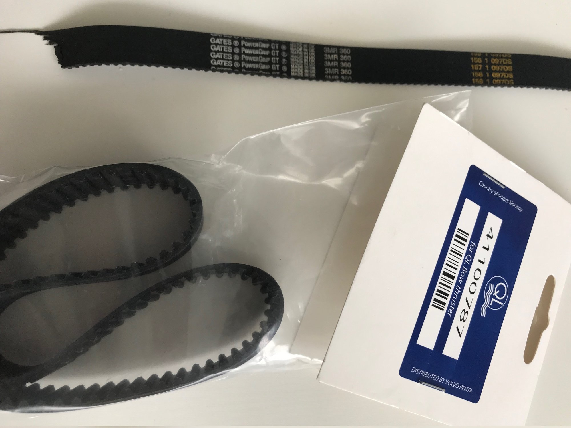

Gpk 0 Postad 1 Juli , 2019 Tack för omtanken Venezia Kan vara mycket bra om inte min beställda QL rem passar. När jag letat i detta ämne har jag hittat att Transportstyrelsen gjorde en varning 2007 https://www.transportstyrelsen.se/sv/sjofart/Fritidsbatar/Sjosakerhet/Bristfalliga-produkter/Bogpropeller-Volvo-Penta/ på dessa små maskiner då en bogpropp orsakade en båtbrand. Åtgärden man gjorde var att byta styrboxen men nu har alla dessa utgått. Upptäckte att min rem blivit skadad av att min motor gick varm och stannade ( värme säkringen löste ut) så remmgummit smälte vid motorhjulet. Kan vara bra att veta för oss som har dessa kvar. Så här skrev Volvo Penta i sitt recall 2007 och nu har alla dessa små modeller utgått från Engbo och QL. ( Dom är ju samma) Volvo Penta/QL CT600, CT900 Bow Thrusters 12-Volt and SP600, SP900 Stern Thrusters 12-Volt. Dear Boat Owner: This letter is intended to notify you of an important safety recall campaign involving the thruster on your boat. Recently, Volvo Penta become aware of several incidents where these thrusters have overheated during operation. At least one incident resulted in an electrical fire onboard a boat. To address these risks, Volvo Penta has started a safety recall to replace the thruster control box, to check system installation and connections and to provide revised, detailed operating instructions for use. New control boxes will be available soon. Please contact your Volvo Penta dealer to arrange for this important service. The campaign is estimated to take approximately 1.5 hours, and the service will be performed at no expense to you. If service is delayed, the bow thruster or stern thrusters can be used safely by following the instructions below: • Use thruster only in short bursts of time, not to exceed four (4) operating periods of 30 seconds each within a 25 minutes span of time. • When not in use, the make sure the main circuit breaker for the thruster is in the off position. We apologize for this inconvenience, and appreciate your cooperation. Dela detta inlägg Länk till inlägg Dela på andra webbplatser
Gpk 0 Postad 4 Juli , 2019 Denna rem storry fortsätter. Remmen till QL passade inte trots att det är en Engbo Propeller. Både för bred och fel längd och tandning. Har dock hittat en firma i USA som har GATES remmar och fann exakt rätt rem i deras katalog men när jag ska lägga order skickar man inte på export utanför USA, ytterligare ett moment 22. Ska kolla om man kan få ordna hämtning av DHL själv som tar den till Sverige. Funderar dock på att plasta igen infästnings hålet i trumman och hitta en ny bogpropeller som inte har rem utan riktig vinkelväxel. Blir dyrt men detta tar för lång tid att hålla på att leta delar. Ni som hittade rem i Sverige kan vara glada och hoppas dom håller båten ut. Bifogar bild på min trasiga rem och den jag hittade hos Volvo Penta postorder Dela detta inlägg Länk till inlägg Dela på andra webbplatser
Venezia 1 Postad 4 Juli , 2019 https://buybearings.co.uk/range/gates-powergrip-gt3-range?gclid=EAIaIQobChMIjJW1tLSb4wIV0KSaCh0SVwkcEAAYASAAEgKz2vD_BwE Prova här. Ser ju på din bild att den är made in Uk, borde ju gå att få tag i där då. Var det jag hade för mig gällande min rem också. //Jörgen Dela detta inlägg Länk till inlägg Dela på andra webbplatser

Gpk 0 Postad 26 Februari , 2020 Ursäkta mitt sena svar men här kommer info på remmen jag köpte i USA 5 juli 2019 kl. 22:00 skrev Philip Biedler <support@biedlers-belts.com>: We can offer 2 of the Gates 9390-5120 (3MR-360-15) belts for $9.53 each ($19.06 for 2). The lead time before shipping is about a week. Shipping to Sweden via US Postal Service First Class Mail International would be $14.25. If you would like to proceed, we can send you an invoice through PayPal that you can pay with a credit card. Thanks, Philip Biedler www.biedlers-belts.com Vill gärna höra hur det gått för er som bytt rem och hur ni fick loss propelleraxeln från växelhuset . Ser ut som den bara sitter med en yttre bricka sen en klämmring. Bytte ni även lageret när ni plockade ut axeln? Ska försöka få till en fungerande bogpropp till denna säsong. Tack på förhand Peter Dela detta inlägg Länk till inlägg Dela på andra webbplatser
