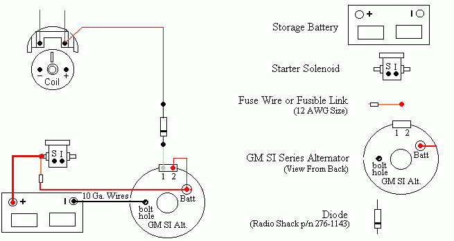

bifogar lite scheman jag har hittat på gm 10 si.
jag bygger mina antagenden på följande.
  1. This is the main power wire that goes directly to the battery. Make sure it is a heavy gauge since it has to carry the full output of the alternator (up to 100 amps).
  2. The leftmost of the two spade connectors around the perimeter of the alternator (will sometimes be marked "1").
    This is the field wire that energizes the alternator; without it, the alternator won't start charging. It must be switched, or else it will drain the battery overnight. Do not wire this into the coil power wire that you use to switch the engine on and off (a seemingly elegant solution, since it would save a switch), since once the engine is running the alternator will feed power back through this wire, which will then power the coil, and you won't be able to shut your car off.
    If you wire a lightbulb into this line, it will serve as an 'idiot light' that you can put on your dash. Why do that? In a derby you can't actually hear your own car running, so if you're not using an oil pressure gauge or voltmeter, this will tell you when your car has stalled.
  3. This is the lead for the sensing wire that helps regulate the output. For derby purposes it isn't needed so it can be either left off or jumped over to the main power wire.
  4. This is the regulator bypass hole. Sticking a long thin metal object about 2 inches deep into this D-shaped hole causes the alternator to go to full charge. If you do this while it's dark out and the main power wire is disconnected, the whole alternator will emit a cool X-Files type glow. I don't recommend that you try this since you'll likely end up toasting your alternator.
Nej, den vita skall kopplas till kolet som inte är 0 eller14 volt, och sedan måste du se till att säkringen sitter rätt, positiv eller negativ reglering. T2 är den inbyggda regulatorns extra spänningsavkänning så den kan du skippa eftersom sterling tar över i alla fall.

B+ & T1 samt field kabel är det som skall användas då.
